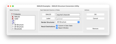

After assigning column roles:

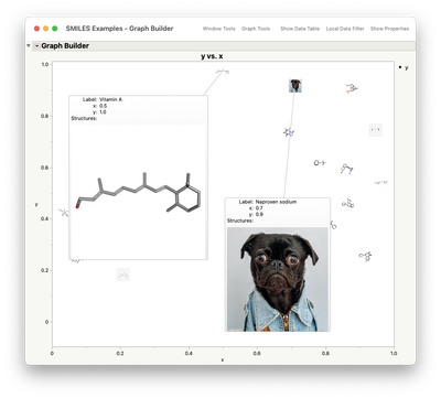

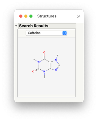

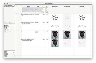

this add-in allows you to see a picture of the chemical structure(s) associated with any selected row(s) in the table (no matter how those rows were selected). The add-in has options to store the structures in a report window,
or in the data table itself for use as markers or in hover windows (perplexed puppies are automatically substituted when a structure can't be found).
