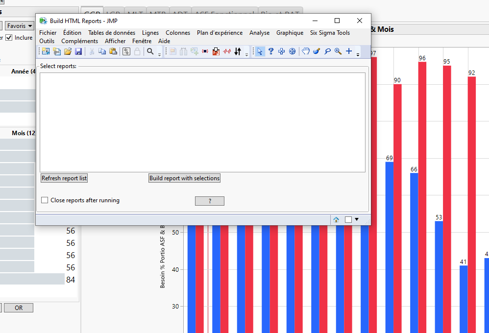

To get started generating your report click on the Refresh report list button to populate the list with all open JMP reports.6596_3.pngIf you want all the open reports to be part of the final output, you don’t need to select anything. If you want just a subset of the reports to be part of the final report, you can select them in the list.  If you want to close all open reports after running the application, select Close reports after running. When you are ready to generate the report, click the Build report with selections button.
