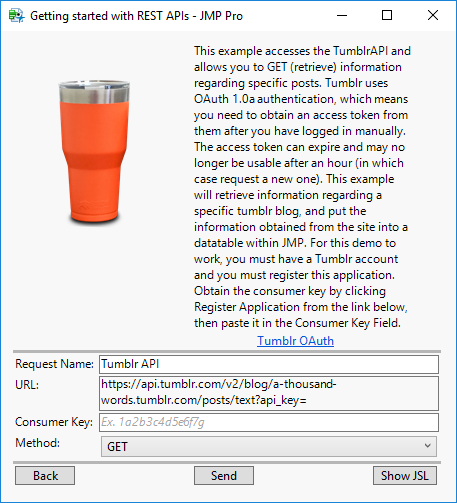

![tumblr.png tumblr.png](https://community.jmp.com/t5/image/serverpage/image-id/11721iB629D77648A16357/image-size/large?v=v2&px=999)
- Look at the Tumblr This has a more complex level of Authentication known as OAuth (specifically OAuth 1.0a); it requires the use of a Consumer Key, Consumer Secret, Token Key, Token Secret, and depending on the API being used, more or fewer parameters to access or post information.
- In order for this to successfully work, register for a Tumblr account, and register an application to utilize with OAuthentication.
- After all of this is complete, copy the OAuth Consumer Key and paste it into the textbox below. Click “Send.” Information regarding the current Tumblr account should be obtained in a Log.
- Click the “Show JSL” button to see the code behind the script.
