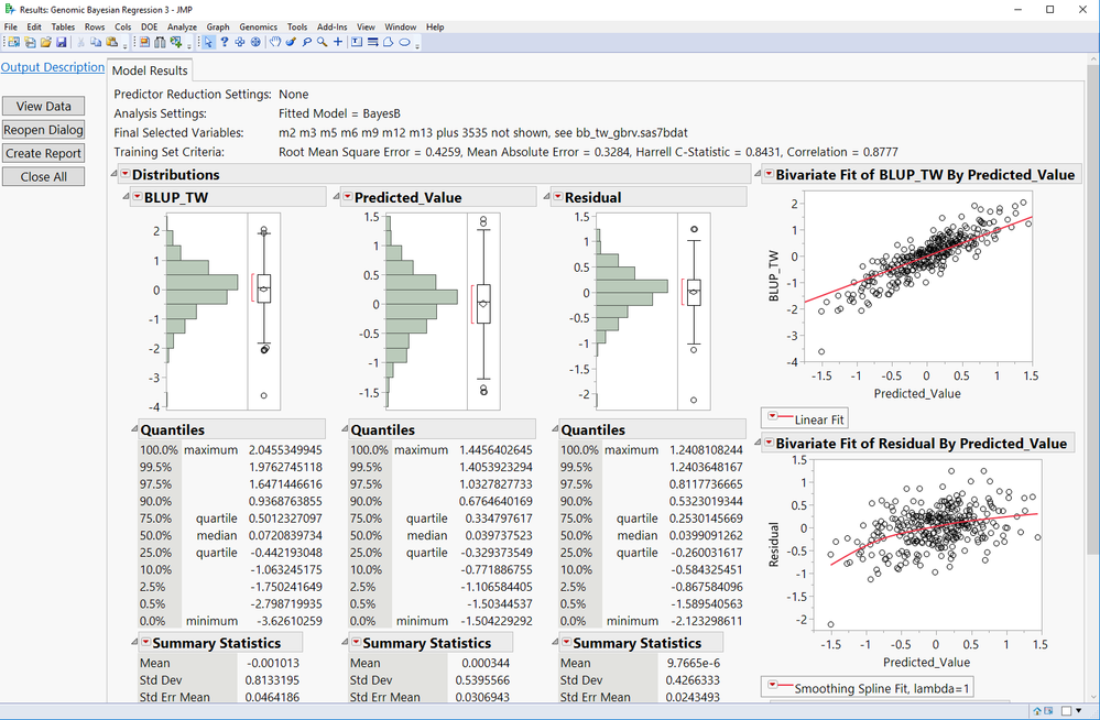

Figure bellow shows the Bayes B method fitted to a barley data set. Notice the correlation between predicted and observed trait values is 0.8777.

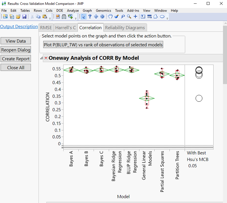

Figure bellow shows the average of correlation between predicted and observed trait values obtained by 3-fold cross validation ran for 6 iterations. Therefore, the correlation shown in the plot is the average taken over 18 runs for each tested model. While the average correlation for Bayes B is 0.5357 in the cross validation runs, the correlation for Bayes B in the entire data set without cross validation is 0.8777 (shown in the first figure). This example shows the importance of comparing models through cross validation to get more realistic measure of predictive accuracy.
