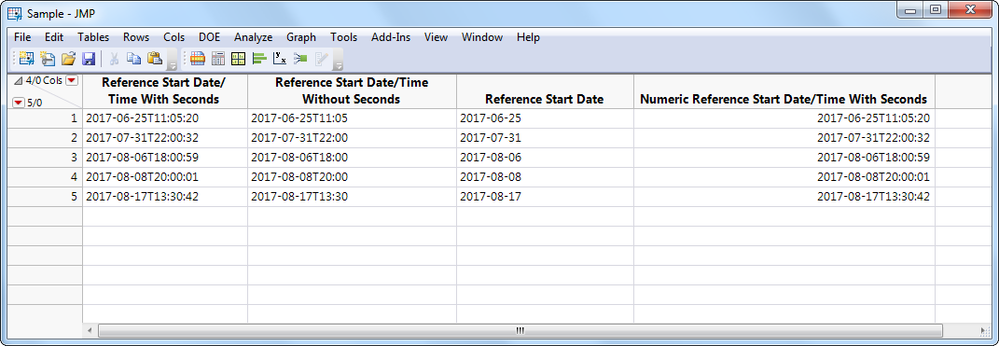

will create a numeric version of the column

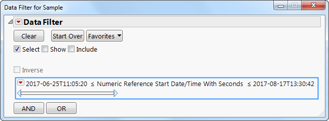

Creating a data filer on the numeric date allows you to select a range of dates.

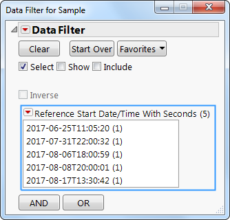

Compare this to a filter on the character version of the date that only allows for selecting specific dates.
