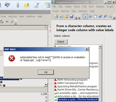

When I try to use this, I get an error message:
Also, in the previous version, the coded version did not pick up the value ordering, so the numbered codes were not in the correct order (the numbered codes were in the alpha order of the labels, rather than the meaningful order, which I set with "value ordering". It would be so great if the script would use the value ordering property!
Hi!  Interesting error - can you share a data set that I can use to reproduce the error?
