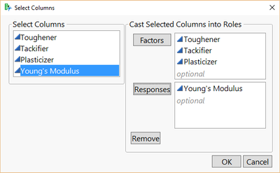

Disguising the Design
Once data have been collected you will need to disguise your design. Simply use the “Disguise” command:11169_chapter 5 data.png11170_chapter 5 column select.png

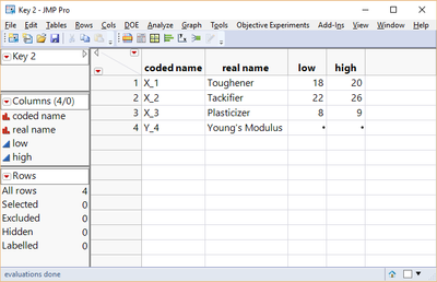

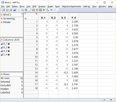

This will produce an Analysis Key and a Disguised Design:

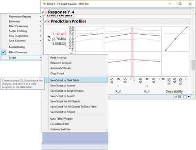

The analyst needs to save his final analysis as a script:

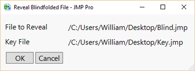

When the analyst returns the disguised design, you can reveal the analysis:
Now you just need to run the Fit Model script and Maximize Desirability to find a Sweet Spot.
