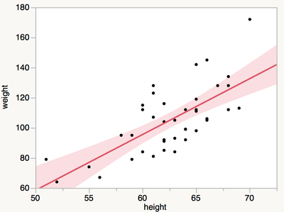

Add-in to copy graph without window background
This add-in adds a menu item (under the Add-ins menu) to copy the currently selected item in JMP without the default window background. This is especially useful when copying graphical output to a document with a white background (such as publications and websites).
Instructions for use:
1. Install add-in by double-clicking downloaded file.
2. Select a graph using the selection tool (fat plus sign).
3. Select "Copy without background" from add-in menu.
4. Paste graphic to desired program.

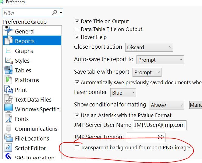

@martindemel
 @rcookie I guess it is due to a preference setting in JMP (though I guess the add-in tries to set it?):transparentBackground.JPG
Does changing this setting change something with the output too?
rcookie
@martindemel yes it is, perfect!
I'm not sure the add-in actually sets this preference, but in any case this setting does remove the background even for other image formats than PNG (windows metafile for example).
