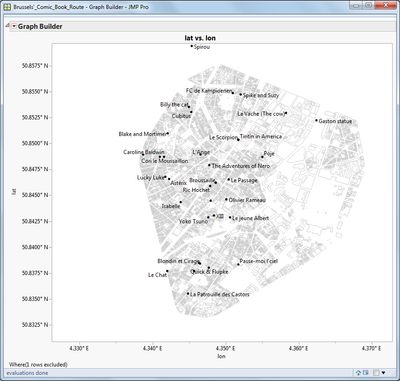

This Add-In provides methods to:
  • Geocode Addresses (requires R)
  • Ease the Import of Foreign Shape Files
  • Create Distance Matrices (requires R)
  • Solve Traveling Saleperson Problems (requires R)
  • Calculate Measures for Spatial Autocorrelation (Moran's I and Geary's Ratio)

Really nice Visualization Sebastian, simple and clear.  Thanks for your efforts on this Add-In.
