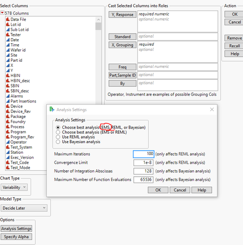

Is there any way to choose EMS as default in Variability Chart analysis settings? JMP chooses best analysis (EMS or REML) but I need to replicate a legacy system which uses EMS only.

I'm sorry but I don't know any way to force the Variability Chart to use only EMS. If the data are balanced and no variance components are negative then you will get EMS. If your legacy system is reporting a 0 or negative variance component then it is not a reliable analysis.
