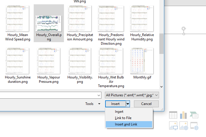

Powerpoint is the typical medium used to present findings to non technical staff. Due to a rapidly changing environment refreshed analysis is required. This often involves have to refresh reports and can be a lengthy process to crop images and setup presentation. A potential work around for this is to offload the image generation to JMP and then link these images in a PowerPoint template. This eliminates the need to spend considerable resources. dt051224.gif

Once the images are generated can then link the Powerpoint presentation to the image locations as below, so that when you refresh or change the images they will be updated in the Powerpoint, this saves having to go regenerate slides and copy/paste pictures as the format you generated is saved as is the style of the images generated so that the report is consistent regardless of time frame analysed. This methodology can easily applied to any form of data.
