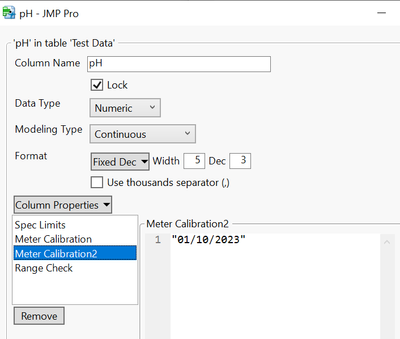

I tried to run the Set Property without "Eval", It still works. (Currently using JMP 16.2)
:pH << Set Property( "Meter Calibration2", Format( Today(), "m/d/y" ) );
