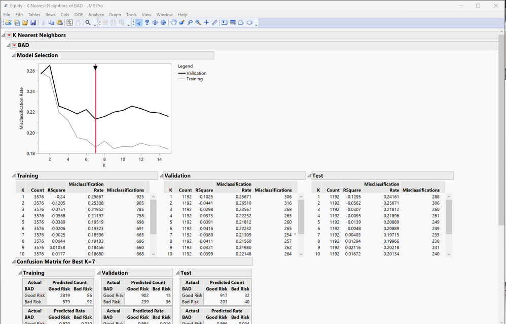

Different values of k can give different predictions. In JMP, you only need to specify the maximum number of k. For each k, 1 ≤ k ≤ k_max, JMP builds a model using only the training set observations. Each of these models is used to classify the validation set observations. The validation set results are used to select the model with the lowest misclassification rate (aka the best k).

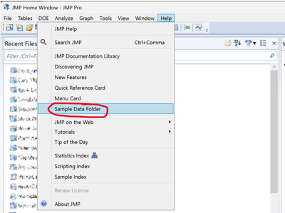

  1. Select Help > Sample Data Folder and open Equity.jmp.

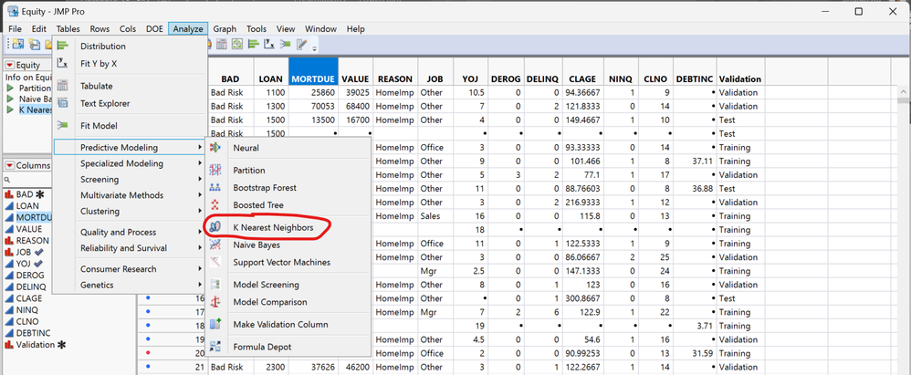

  1. Select Analyze > Predictive Modeling > K Nearest Neighbors.

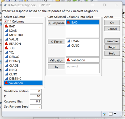

  1. Select BAD and click Y, Response. The is the value to analysis.
  2. Select LOAN and CLNO and click X, Factor. This is the predictor variables.
  3. Select Validation and click Validation. This is the value used to partition data into sets before modelling to avoid overfitting and select a good predictive model. We used Train, Tune, and Evaluate method in the example.
  1. Click OK.

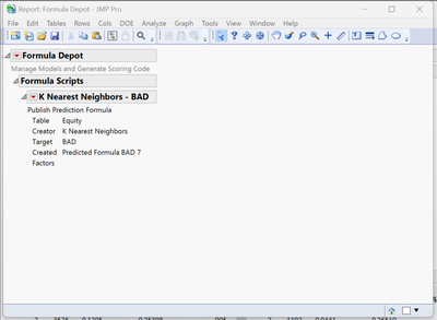

To save the prediction equation
  1. Right click the BAD red triangle and select Publish Prediction Formula.
  2. Next to Number of Neighbors, K, leave the default value of 7.
  3. Click OK.
The prediction equation is saved in the Formula Depot. You can compare the performance of alternative models published to the Formula Depot with that of the K = 7 nearest neighbour model using the Model Comparison option in the Formula Depot. Find more information regarding the Formula Depot in Help/JMP Documentation Library, page 3763.
