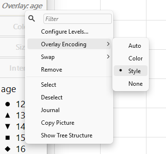

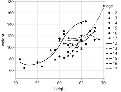

Re: Graph Builder Workshop User group meeting DACH 2026 - Katharina Lankers (SCHOTT)
Marker Legend without coloring:
via Overlay encoding?
Names Default to Here(1);
Graph Builder(
	Variables(
		X( :height ),
		Y( :weight ),
		Overlay( :age, Overlay Encoding( "Style" ) )
	Elements( Points( X, Y ) )
hogi
Level XIII
additional "legends" can be added by adding additional point plots
(with points outside of the current plot region)
... and row states can be used as dirty hack to assign the markers to the corresponding rows.
[if Overlay + Color is not what you want]
