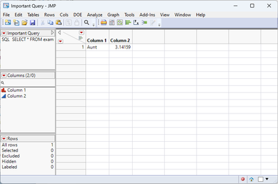

I tried something similar, and it did not appear to pass the NOLOCK option to SQL Server.  When I use New SQL Query(), I use CustomSQL, like this:
New SQL Query(
Connection( cnxn_string ),
QueryName( "Important Query" ),
CustomSQL( "SELECT * FROM example WITH (NOLOCK) WHERE [Column 2] > 1" )
) << Run;
I am not sure there's a way to send the NOLOCK option without using CustomSQL within New SQL Query() or by using the Open Database() function.

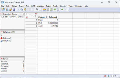

You can prepend the entire SQL statement with "SET TRANSACTION ISOLATION LEVEL READ COMMITTED"
or
"SET TRANSACTION LEVEL REPEATABLE READ"
From Microsoft: (link to page)
READ COMMITTED:
Specifies that statements cannot read data that has been modified but not committed by other transactions. This prevents dirty reads. Data can be changed by other transactions between individual statements within the current transaction, resulting in nonrepeatable reads or phantom data. This option is the SQL Server default.
REPEATABLE READ:
Specifies that statements cannot read data that has been modified but not yet committed by other transactions and that no other transactions can modify data that has been read by the current transaction until the current transaction completes.
So WITH(NOLOCK) is basically the same as READ UNCOMMITTED, but it doesn't matter, because WITH(NOLOCK) will override READ COMMITTED or REPEATABLE READ.
New SQL Query(
CustomSQL( "SET TRANSACTION ISOLATION LEVEL READ COMMITTED
SELECT * FROM test1.dbo.example WITH(NOLOCK)
WHERE [Column 2] > 0.5" )
) << Run;
