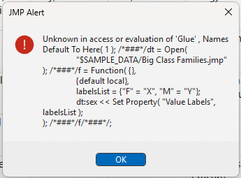

much more difficult to understand was the initial error message:
delete symbols (::labelsList);
Names Default to Here(1);
dt = Open( "$SAMPLE_DATA/Big Class Families.jmp" );
f = function ({},
	{default local},
	labelsList = {"F" = "X", "M" = "Y"} ;
	dt:sex  << Set Property( "Value Labels", labelsList )
f

Unknown means JMP caught an unexpected error and has no better explanation. Report it and explain what you think it should do; a developer will get a chance to fix it, either by making it work in a reasonable way or by making the message better.
Craige
