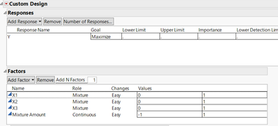

Thank you Dan. Could you please clarify at which step do you specify that the "Amount" variable is actually the sum of the mixture components?
Re: "Mixture-Amount" DOE in JMP
It would be when you are adding factors to your Custom Design:
