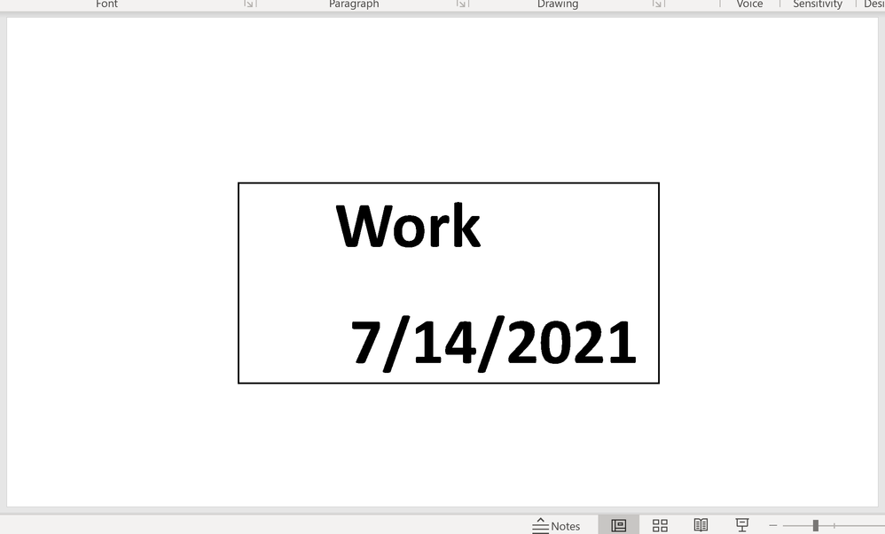

Folks,
I've been fiddling with the text box and spacer formats so I can get an even (white) background when I save the title slide to PowerPoint. However, I cant get the backgrounds and borders to be white instead of grey (see image). I've worked on text box widths, etc, but to no avail. I've attached my script.
If anyone can see what I need to do, I would be most appreciative. Also as a side note, is there a more eloquent way of tabbing the second text box (date) to align with the first text box?

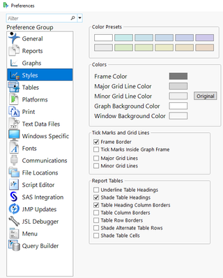

In the Styles section, it looks like the Window Background Color is not set to white by default. I'm not sure but it is possible that this default color applies to Spacer Box too.

Just a thought: have you look into the preferences where I believe you can define the color of different elements in JMP.

Many thanks for the input. I looked through the preferences, but didn't see anything that jumped out at me. Would there be a particular "Preference Group" that would be applicable?

Your right on the money!!  The Window Background color is the overall solution. I'm guessing there is not a specific JSL command that would modulate this option without going into preferences?

You can access the preferences with JSL.
