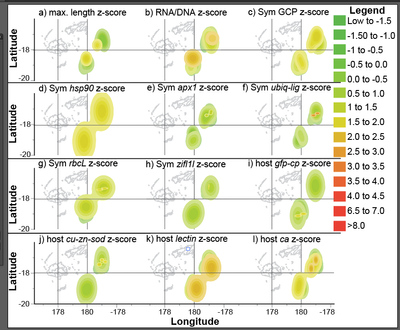

Hello,
   I have routinely used JMP to overlay data on maps, a feature that I love. Normally, I standardize my data to where they are all on the same scale, stack the columns I want to plot, and overlay the stacked data in Graph Builder (as contour plots; see attached image for an example). However, I now want to overlay data from multiple parameters WITHOUT first standardizing them (so that they maintain their original scales). I realize I could make individual plots, copy them, and paste them into Adobe Illustrator, but I would prefer to use Graph Builder and wrap by parameter name ("label") if at all possible. Is there a way I can stack columns that are NOT on the same scale and then build a map-based graph in which they feature different y axes? I have posted a datasheet in which I would like to plot temperature, salinity, and ALCC onto a map. Thanks!

Is this the kind of thing you are looking for?

Jim, I completely forgot that combining windows was an option and did not realize how easy it is to copy JSL scripts to a common script window, so I think this will work. Basically, I am trying to make publication quality figures without the need to use Illustrator to merge different graphs, plots, etc. I like your script because it just shows the figures, not with all the confusing boxes and containers found in Dashboard! Thanks!
