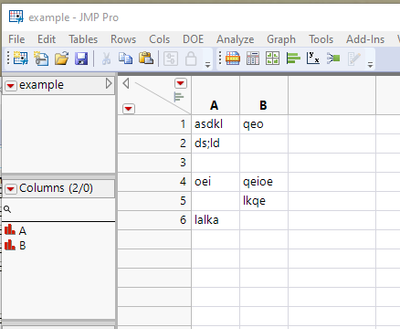

Your code works fine.  Given a data table
and running a copy of your code

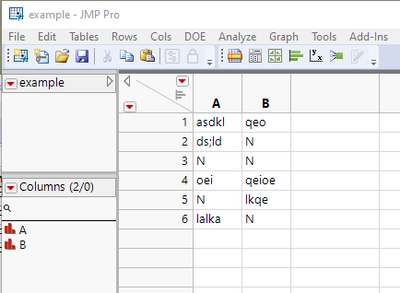

It results in the following
The issue you may be having is if your A,B,C,D,E columns are numeric, you will not be able to place a character value into the cell.  JMP will convert it to a missing value "."
