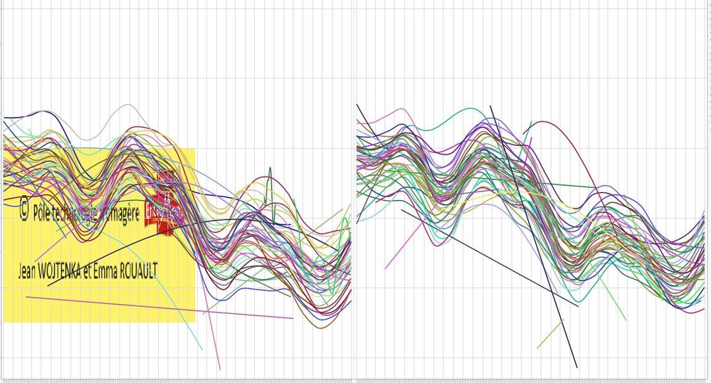

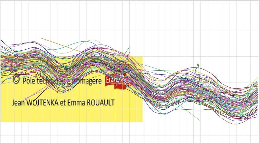

Hi,
In some cases, we need to put a logo or copyright in the background of a graphic if we send the graphic into an email for example.
How to set the sizes of the logo or copyright, text, comments if we change the graphic (cf. the image with an additional variable at the top of the graphic) ?
Thanks for your help;
best regardsCapture with good sizes for the label.JPGCapture JPG with problem.JPG

Hi Francoise,
Would something like the example below would work for you? You would need to define the location of your logo, its size, and the basic graphic script for your graph but this would produce a scaled logo for any range of X and Y.

gb = dt << Graph Builder(              // Main GB Script
			Fit to Window( "Off" ),
			Variables( X( :X ), Y( :Y ) ),
			Elements( Points( X, Y, Legend( 3 ) ) )
gbr = gb << report;
Xax = gbr [AxisBox (1)];
Yax = gbr [AxisBox (2)];
Xmin = Xax << Get Min;
Xmax = Xax << Get Max;
Ymin = Yax << Get Min;
Ymax = Yax << Get Max;
fb = gbr [Frame Box (1)];
img = Open ("$SAMPLE_IMAGES/windmap.png", "png"); // path to the background image
fb << Add Image ( image( img ), bounds( top( Ymax ), Left( Xmin ), bottom( Ymin ), Right( Xmax ) ));
Let us know if this is anywhere close to what you are looking for. If not, you may want to provide some more details to your inquiry.
