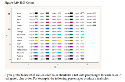

I have no idea where to find named markers, but Scripting Guide's section Colors and Markers seems to have list of markers (in numbers)
Also for colors you can see this "table" and also check out Specify Colors section for standard JMP Colors table
