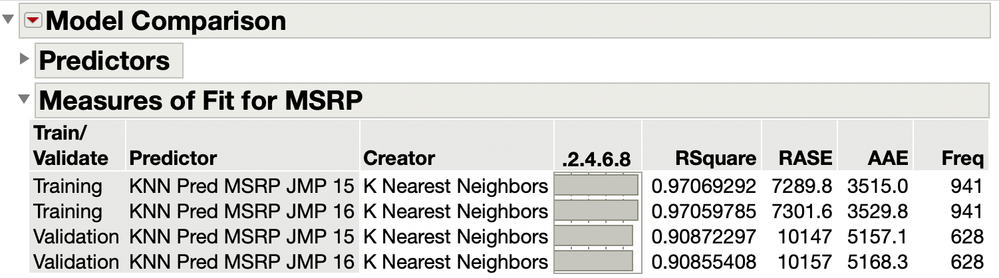

Is it possible you may be comparing r-squared from different models? For example your table has Least Squares model with fairly different fit statistics than the KNN model.
I ran KNN as described on your data set in both JMP 15 and 16. The training and validation r-squared statistics for version 15 and 16 are slightly different but very similar. (random seed was the same), the script is blow. Not included are comparisons between 14 and 15, which were identical.
If someone from JMP Dev doesn't comment, maybe send a note to support@jmp.com and reference this discussion thread. Although I don't know any details, I suspect the method behind KNN was updated to support very wide tables. It is possible that JMP16 is providing a more precise estimate.
