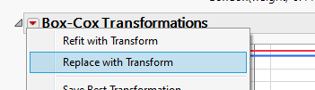

If you want to apply a Box Cox transformation before fitting the data, you can use the Fit Model  platform and in the red triangle menu select
Then go to the Box-Cox menu and select
and you will get a fit for the transformed variable:

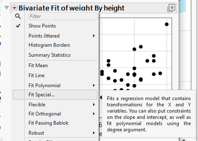

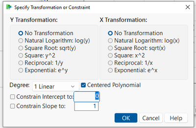

A third option: go to Fit Y by X and use Fit Special ...
In the menu you can pick some common transformations for X and Y axis:
MaureenS
Level II
Re: is there something like the curve fit platform where you can try different transformations of data to find the best linear fit?
thanks!  this is the type of thing I was looking for.
