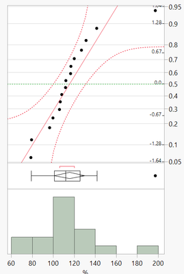

so basically, yes my data are very scattered and no pattern to follow. huge variation and that is why i need to understand my process and why all these variations.
for distribution, i assume it is normally distributed. check picture below of normal quantile.
i did include speed and time full factorial.
