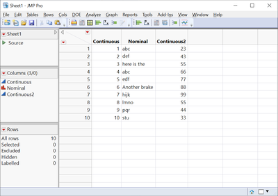

Thank you  @Byron_JMP for your suggestion. But it didn't work in my case, perhaps we have different import settings.

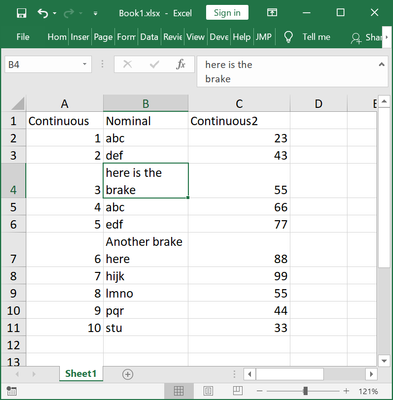

my original table in excel looks like this, with line brakes in cells B4 and B7

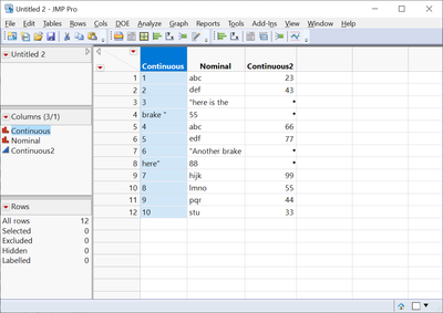

using the on the fly copy and paste with column names i get the following image. where every line brake is interpenetrated as a new table row,
using the import wizard i get the following where the original line brakes within the cells have been removed together with the reminder of its content.

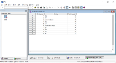

when opening the excel file in SAS using default settings, the result is much better. The line brake in the cell was just removed. This maintains the overall integrity of the cells, rows and columns of the file.
Iit would have been better to add a space though. Not sure how i would be able to add it myself later if i had to use the text for analysis.

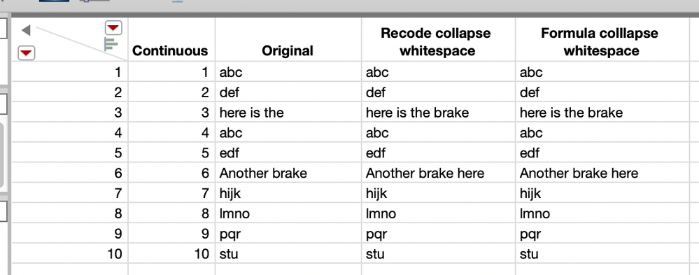

I opened your Excel file with the Excel Import Wizard.
Then used both Recode as well as a formula to collapse whitespace
Both approaches use the same function. Although the function is called Collapse Whitespace, it might as well be called, One space between each alphanumeric symbol in a string.
Although we aren't talking MS stuff here, diagnosing the issue in the Excel sheet is more important because it is a data entry error there, as well as a source of miserable problems in Excel too. The hard return can either look like a no space at all, or maybe a space if the wrap role it turned on. Either way its a S in S out kind of problem.
