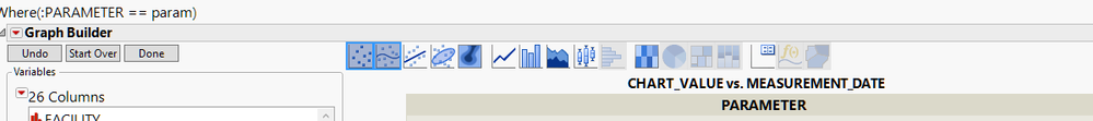

I have a script, that creates multiple graphs by parameter and put them in a report window.
the output creates a text above the outline box "Where parameter=param", i would like to remove that. how can i do that?

All you need to do, is to find the top of the display tree, and then delete the first text box, which is the display of the Where clause.  See below

	tp = Report( gb ) << topparent;
	tp[Text Box( 1 )] << delete;
