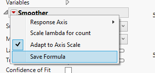

From which platform? From Graph Builder you can save the formula

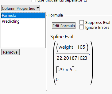

and you will get the values in your table with the formula which will look something like this

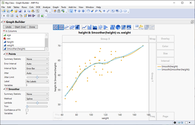

Blue in the graph are the smoothed values
