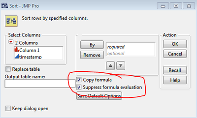

I think it performs the task as you requested it.  The problem regarding rearranging the tables is common to all formulae.  But since your request was for a formula solution lets not give up yet.  First when you sort there is an option to prevent re-evaluation, or even better, drop the formula by not copying it

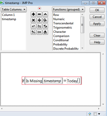

But on the basis that there may be some other operations you perform which trigger re-evaluation then the formula can be revised to evaluate Today() only if there is no current value:

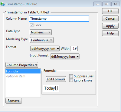

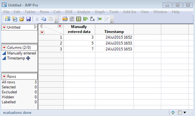

You can use the Today() function and format the column as a date time:
As new rows are added as part of the manual data entry the formula with me evaluated:

Dear David,
Dear Eric,
Thank you for your help but it does not seem to perform the task. Yes it does when entering data but if you make any arangments (like I do as sorting the data) the Record Date column with Today() formula resets itself.
