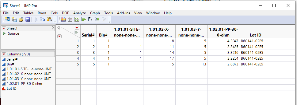

how to create a script to import xls to jmp
i have a problem about import xls file to jmp using script
i want to import this file using row "7" as header and add new column "Lot id" fill data as B3 cell data (B6C141-02B5) into new column
how can i do this
thank you
I used the JMP Excel Wizard to open the file interactively and then copied the Source script that JMP created to place into the script.  The script reads in the file twice.  First to read the data, and then the second time to read in the Lot ID.  I then just added the code to let you select the Excel file to import, and the JSL required to create the new Lot ID column.

I think you will need to know a little JSL, and this should get you started. The 'best' approach will be determined by what you can (and can't) assume about the structure of the data beyond the example you have given.
This code is not at all robust, and assumes your file is in the 'downloads' folder. If you look at 'Help > Books > Scripting Guide' you can probably figure out what it's doing (depending on how much coding experience you have).

Re: how to create a script to import xls to jmp
As both txNelson and Ian mentioned, your data table does not have a really good format for a statistical analysis, however this is unfortunately quite often the case in industry, especially when spreadsheet tools are mainly used. Statistical data should be in columns and rows in a rectangular form whenever possible. Otherwise you need to specify each cell for the calculation instead of using vectors and matrices, which would be much more efficient. That's why txNelson imported the sheet twice and extracted the information, as Ian did in a similar fasion.
