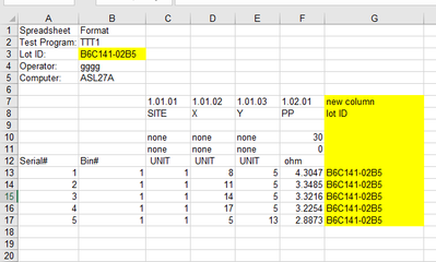

how to create a script to import xls to jmp
i have a problem about import xls file to jmp using script
i want to import this file using row "7" as header and add new column "Lot id" fill data as B3 cell data (B6C141-02B5) into new column
how can i do this
thank you
I used the JMP Excel Wizard to open the file interactively and then copied the Source script that JMP created to place into the script.  The script reads in the file twice.  First to read the data, and then the second time to read in the Lot ID.  I then just added the code to let you select the Excel file to import, and the JSL required to create the new Lot ID column.
