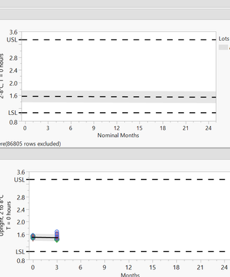

Hello everyone,
I am having two graphs individually and I would like to have one graph on the other.
I tried using combined windows and copy pasting frame contents but when I hover over the mouse to the pasted graph contents the values aren't popping can anyone help me out in solving this.
Thank you,
Hanuja

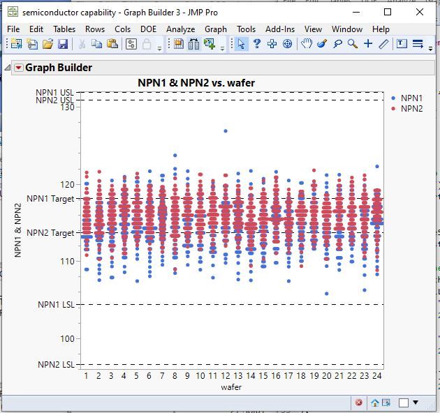

txnelson
Re: how to combine 2 graphs i mean like overlaying one on the other
While it is easy to overlay graphs using Graph Builder, there is a problem with displaying Spec Limits when more than one columns is overalyed.  However, it is a simple process to add a little script that will add the reference lines.  Here is one way to do it

txnelson
Is the graph that I proposed, an acceptable combining of the 2 graphs? If not, and you need to have the different overlays as defined in your 2 scripts, then I am not aware of a way to cut an paste the graphs from 2 different data tables.

txnelson
Here is an example that somewhat resembles your 2 data table input that needs to be put together into one plot.  You need to study the script, and then take the new information and apply it back onto your scripts.
Here is the script
