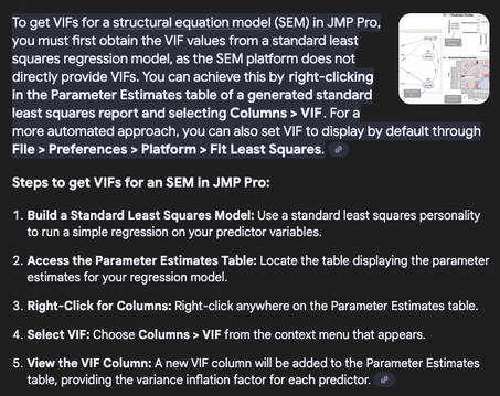

With respect to your Google search, you're not doing anything wrong: Google's AI Overview is incorrect about VIFs in the SEM platform. Google appears to be reporting information from the Fit Least Squares documentation despite your question being specific to SEM. And somewhat frustratingly, when I asked Google the same question (but perhaps with slightly different wording), the AI Overview correctly reported that the SEM platform doesn't report VIFs. So it gives two mutually exclusive answers to the same underlying question! These LLMs are amazing in many ways, but I recommend checking the cited pages whenever the information you've requested is particularly important to you. I've many times found that the AI Overview has made false statements.
