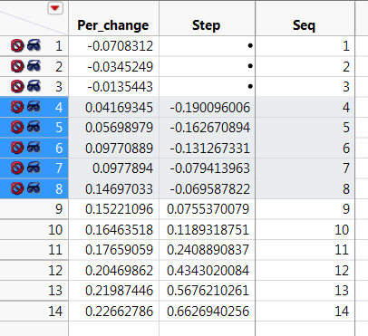

I have two columns (per_Change) and Step (it's a formula based values) and Per_Change column is sorted from -ve to +ve values.
In my script i need to know max rows so i created rank column from 1-14 (ascending order as attached image) and need to have atleast 8 rows (starting with highest rank).
Steps:
1. Exclude -ve values in Per_Change column
2. then in Col Step is based on some formula, and it will create some "-ve" and "+ve" and some "null" values. Hide and exclude all -ve values in col Step. the null values were already hidden and excluded based on Col Per_Change since formula will generate -ve values.
3. My requirement is to have atleast 8 values (descending order). In my example there are 6 clear row states (rank 9-14)  (2 additional rows should be from descending i.e. unhide/unexclude rank 8 and 7 but should not include "null" values in a scenario if there are more null values and fewer -ve or +ve values in col Step).
Step 1 and 2, i am able to perform in JSL script but am having issues in enabling 2 additional rows.
I tried using lag function and also creating dummy columns to go enabling in reverse order but am having hard time for unselecting additional rows.
Thank you!

CG, I attached a data table, named PerChangeExample to emulate your example.
Try this script
Names Default to Here(1);
dt = Data Table("PerChangeExample");
dt << select where(:Per_change < 0 | IsMissing(:Per_change) );
dt << exclude(1) << hide(1);
dt << select where(:Step < 0 | IsMissing(:Step) );
dt << clear select;
nexcl = nrow( dt << get excluded rows() );
if ( nrow(dt) - nexcl < 8,
   for(i = nexcl, i > nrow(dt) -8 , i--,
      if ( !IsMissing(:Step[i]),
            dt << Select Rows(i);
            dt << Exclude(0) << Hide(0);
            dt << clear select;
    ); //end for i
); // end if
if ( nrow(dt) - nexcl < 8, throw() ); //stop program execution if still not enough data.

Re: how do i invert Unhide and unexclude rows based on values in few columns
Thank you for prompt reply...it works!
