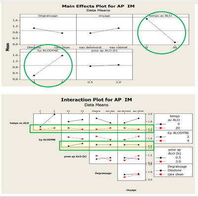

i m struggling to obtain DOE results interpretation in a user friendly way, which are the main and interactions effects ?
i m a former minitab user for years and would like to get support to interprete easily with JMP  DOE results , this is just an example :
The current DOE for which i m requesting support is a simple full factorial design with 3 parameters at 2 levels
Would you please communicate how to obtain similar analysis with JMP ?

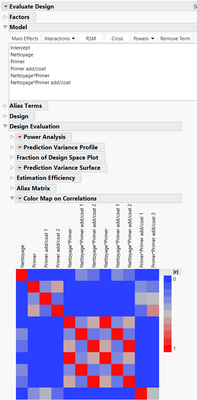

Hello, with only 8 runs you can't estimate all interaction effects. I checked your DOE with JMP design evaluation; in color map below you can see that lot of effect are correlated, including main effects.

The data table does not match your description. There are 2 factors at 2-levels and 1 at 3-levels, so this is not a full factorial?
Typically, you would run the Fit Model platform. This is where you would enter your model and response variables. The output will provide multiple options to display the results both graphically and quantitatively.
