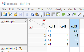

I don't understand your 3 sets of columns.  It appears as if you are changing column names in the middle of a data table, which will not work in JMP.  Is this table format coming from an Excel spreadsheet?
Here is a simple formula that will do what you want for a data table that looks like
I have attached the data table.
The formula used is:
x = :col2[Row()];
If( Row() < N Rows( Current Data Table() ),
	For( i = Row() + 1, i <= N Rows( Current Data Table() ), i++,
		x = x * :col2[i]
x;
This same idea can be used if there are multiple places in a data table that need to restart the multiplying.  The identification of when to restart and when to end would just have to be worked out
Jim

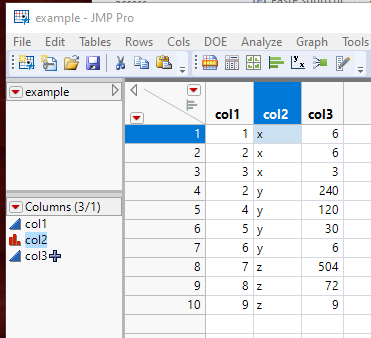

No, my column names do not change. They stay as col1, col2 as given. I would like to add a new column (col3) that does the backward multiplication for a same value given in col2. I'm demonstrating my need in the following table. Could you please help?
col1 col2 col3
1     x     6 (i.e. 1 x 2 x 3)
2     x     6 (i.e. 2 x 3)
3     x     3 (i.e. 3)
2     y     240 (i.e. 2x4x5x6)
4     y     120 (i.e. 4 x 5 x6)
5     y     30 (i.e. 5 x6)
6     y     6 (i.e. 6)
7     z     504 (i.e. 7x8x9)
8     z     72 (i.e. 8x9)
9     z     9
Thanks!

txnelson
Re: how do I multiply each row values backward in one column until a criteria is met
The calculations you want are very easy to do if the data are reversed, so here is a little script that will calculate the values using that idea
names default to here(1);
// create the sample table
dt = New Table( "example",
	Add Rows( 10 ),
	New Column( "col1",
		Numeric,
		"Continuous",
		Format( "Best", 12 ),
		Set Values( [1, 2, 3, 2, 4, 5, 6, 7, 8, 9] ),
		Set Display Width( 48 )
	New Column( "col2",
		Character( 1 ),
		"Nominal",
		Set Values( {"x", "x", "x", "y", "y", "y", "y", "z", "z", "z"} ),
		Set Display Width( 45 )
// JSL to create the column you want
// create a new column to preserve the order of the data
dt << new column("origRow", formula(row()));
dt:origRow << delete formula;
// Reverse the order of the data
dt << sort(by(:origRow), order(descending), replace table(1));
// create the new column
dt << new column( "col3", formula(
	If( Row() == 1, x = :col1 );
If( Lag( :col2 ) != :col2,
	x = :col1,
	x = x * :col1
x;
// Since the formula is dependent on the order of the data, the formula needs
// to be removed and the values set to static values
dt:col3 << delete formula;
// reorder the data table back to the original order and delete the origRow column
dt << sort(by(:origRow), order(ascending), replace table(1));
dt << delete columns(:origRow);
And here is a piece of JSL that will create the new column without sorting
Names Default To Here( 1 );
	Add Rows( 10 ),
	New Column( "col1",
		Numeric,
		"Continuous",
	New Column( "col2",
		Character( 1 ),
		"Nominal",
dt << New Column( "col3b" );
:col3b[N Rows( dt )] = :col1[N Rows( dt )];
For( i = N Rows( dt ) - 1, i >= 1, i--,
	If( :col2[i + 1] != :col2[i],
		:col3b[i] = :col1[i],
		:col3b[i] = :col3b[i + 1] * :col1[i]
Jim

@txnelson
Thanks Jim! I really wish I were a scripting genius like yourself. It works great!
