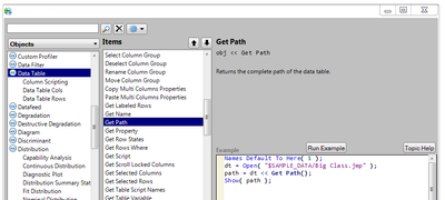

The data table is a scriptable object in JMP.  The Show Properties function works with any scriptable object.  The list is the set of messages the data table responds to.  There is more information, and a similar list, in the Help->Scripting Index.

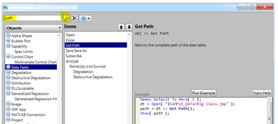

If you know a keyword, like "path", you can narrow the search:
The scripting index can search just Objects, just Functions, just Display boxes, or all three.  In this case, picking Objects, then Data Table, makes it easier because there are a number of Functions and Display boxes that know something about a path as well.

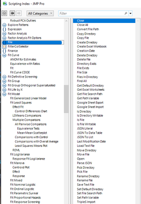

There might be a function which lets you do this easier. If there is one you should be able to find it from File section of Scripting Index
Or from here JSL Syntax Reference > JSL Functions, Operators, and Messages > File Functions , convert file path would be my starting point
