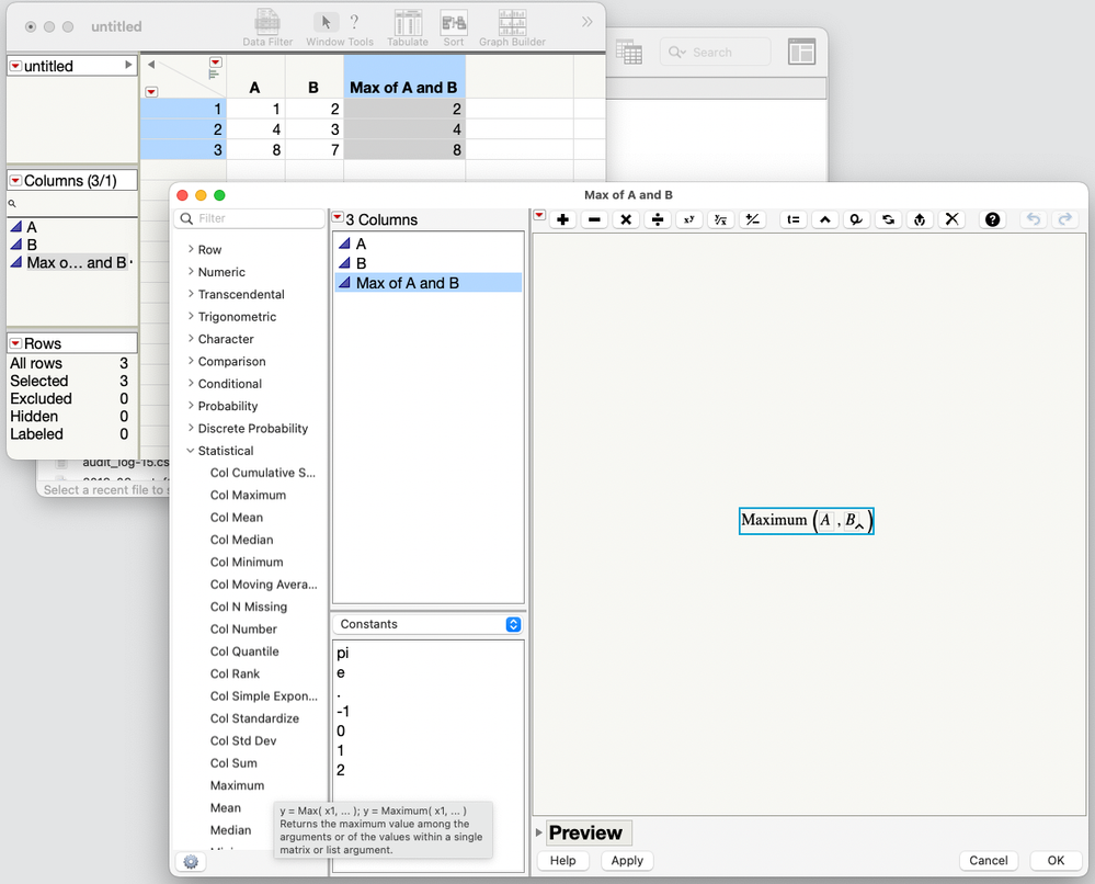

If, on the other hand, you want something like this:
A
B
Max of A and B
1
2
2
4
3
4
8
7
8
Then the formula:
Maximum(:A, :B)
will give you that.
-Jeff

aadecarlojr
Level III
Re: formula to provide greatest numerical value from multiple columns
Thanks to Jeff and TxNelson. I did want the latter, row by row maximum of two columns and that works.  In my research we entered separate R and L data but also want a column variable that contains the max from either R or L.
