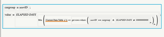

Hi Jim, thank you for the answer. I pasted it into the formula and replace the column name, but it didn't produce the right answer. Could you help me check the below screenshot? Thank you.

The screen dump of the formula does not let me see if you are referencing the columns correctly.  That is, are you placing a ":" in front of the column names, but not in front of curgroup and value?
What error messages are you getting?
When you say that it is not working correctly, what does that mean?  Not getting the correct values, or is it not giving you any results?
I have attached your sample data table with a column called Jim's Formula that has my formula applied to the data table.  This is so you can have a working version of the formula for comparison to what you are attempting to create.
Jim
