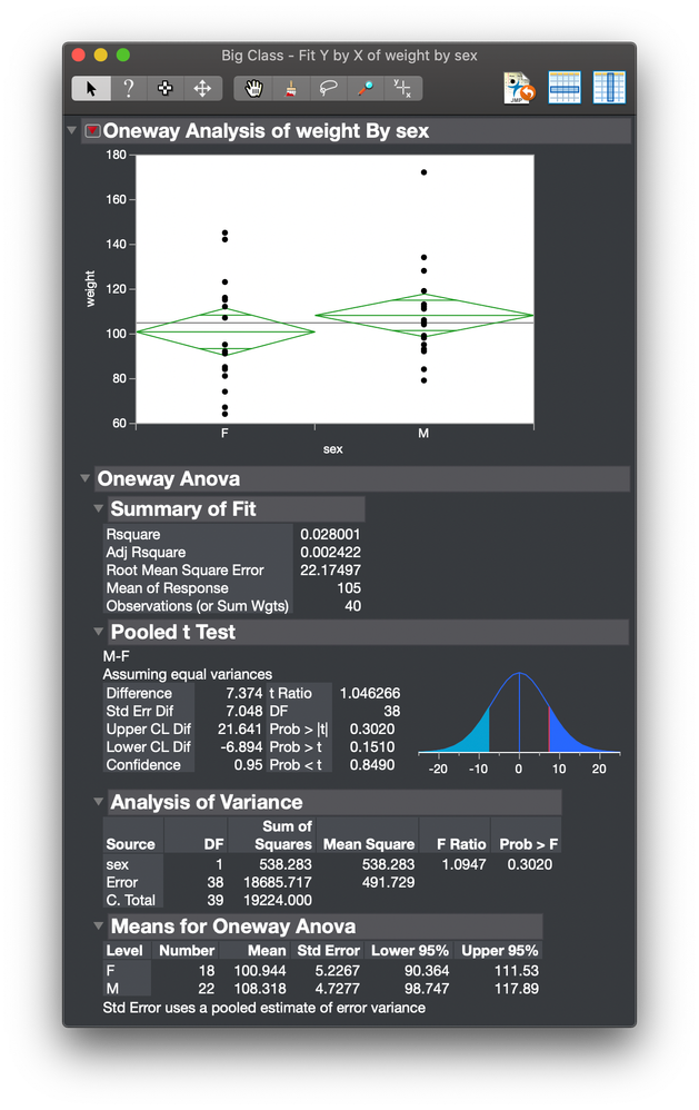

Here is a simple illustration of how to use the bootstrap feature. I opened the sample Big Class data table. I launched the Oneway platform with Y = weight and X = sex. I performed the ANOVA.
Screen Shot 2019-12-15 at 7.12.40 AM.pngScreen Shot 2019-12-15 at 7.12.40 AM.png

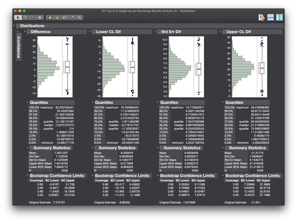

I right-clicked on the table with the difference between the means of the two sexes and selected Bootstrap. I requested the default number of samples, 2500. I used the saved Distribution table script in the data table with the bootstrap results.
Screen Shot 2019-12-15 at 7.12.56 AM.pngScreen Shot 2019-12-15 at 7.12.56 AM.png
