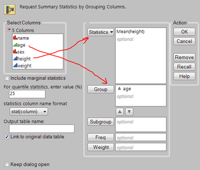

start with Tables->Summary, which will produce a new table.  If you like what you get, there is a Source script (red triangle) you can use in JSL.

Go to Table -> Join and join the new table with the original by matching the AGE column.

Tables->Join does the job of matching up the rows from the short and long tables, using a column you specify to match them.  Again, there will be a script in the joined table if you need it for JSL.
