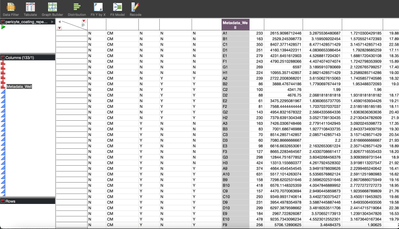

Hi,
I've just upgraded to JMP 15 and have noticed that column names won't display unless they are selected (see screenshot). This also occurs if I use graphbuilder and if I drag columns to different axes they do not show up as well. Any help or suggestions would be greatly appreciated, thank you!

Re: column names won't display
It appears that for some reason, your font color has been set to white. I do not see a preference that handles such color change. I suggest that you first do a new install of JMP to see if that resolved the issue. If it does not, you need to contact JMP Support at:
Could be related to macOS dark theme. Similar issue here: JMP15 Mac OS Dark Mode
