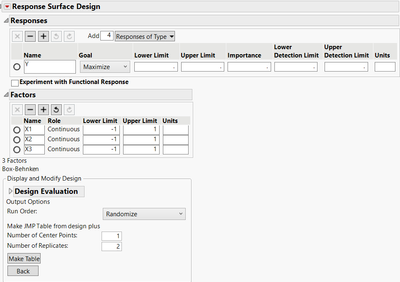

i have a question about blocking in DoE. should we always follow the blocking option that JMP suggest with each design?? or can we do it our way?? for example. i am looking to do Box-Behenken design which has no blocking option at all but i was thinking of (doing all 13 run) in one day as the experiment is very short. then reopeat this over three to five dys and use day as a block were the in total i have 39 run were each 13 run goes for a day. am i correct in my thinking??

Can you provide more details about your experimental setup, objective and design ? I can't find a default 13-runs Box-Behnken design option for 3 continuous factors (minimum is 15 including 3 centre points). Did you change the default number of centre points from 3 to 1 to obtain 13 runs ?
If yes, there are two options to get 39 runs with 2 replicates and the use of blocking:
  1. Create your 39-runs Box-Behnken design with 2 replicates :
    Then, go to the Custom design platform and use these runs as Candidate set in the Custom Design platform (simply select your factors in "Select Covariate Factors"), add a blocking factor in the "Factors" panel (with the specification of 13 runs per block), and specify a RSM model in the model panel). Check the option "Include all selected covariate rows in the design" to make sure that all previous Box-Behnken replicated runs will be present in the final design with 3 blocks.
  2. Or simply create the original 13-runs BB, and then use the platform Augment design to replicate the design 2 more times (number of times to perform each run = 3) and add a block column after the replication with the relevant column properties : Value Order (for the ordering of the blocks), RunsPerBlock (=13), Design Role (= Blocking) and Factor Changes (Easy), and increment the block factor value every 13 runs. The problem with this option is that the order of the runs is the same for each block/day, so it might be better to randomize within each block/day at the end to avoid any pattern/bias throughout the day that could impact the results (linear or complex time trend during the day).
