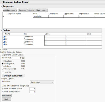

Does that mean your design has around 128 runs ? If less than that, I would recommend following the calculations provided by JMP in the platform, where the alpha distance value is calculated depending on your design specifications. Example here with a CCD for 4 factors :

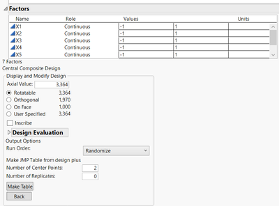

Ok, so you're in the case described before, generating a 7-factors and 128 runs (starting at 144 runs in JMP in the Classical design platform for a CCD) would indeed generate an alpha value of 3.36 for a rotatable design :

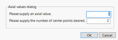

If you're planning on augmenting an initial design to a CCD, then you may need to know "in advance" the total number of runs and centre points you will need to fix the axial value (if you're augmenting your design with the option "Add Axial") :
So you could augment your design to a circumscribed or inscribed design type, but that will require to know in advance how many runs (and types of runs) you would like to add to your original design.
