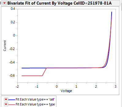

I am creating an application which allows the user to select a few options before running a script which involves a few SQL queries and then making some graphs... nothing too crazy.
A radio button control is used to set the value of a variable named "type"..  I want one of the "fit where" options for a bivariate graph to be the contents of this variable...
Bivariate(
Y( :Current),
X( :Voltage),
Show Points( 0 ),
Fit Where(
:type == "cell",
Fit Each Value( {Report( 0 ), Line Color( {0, 0, 255} ), Report( 0 )} )
Fit Where(
:type == type,  //this is troublesome line... the graph is generated but not quite right.
Fit Each Value( {Report( 0 ), Line Color( {213, 72, 87} ), Report( 0 )} )
By( :CellID)
The graph generates correctly, but the annoying thing is the resulting graph says "fit each value type == type".  How can I get it to display the contents of the variable which was used instead of it's name??  I've tried a few options already including "eval(type)".

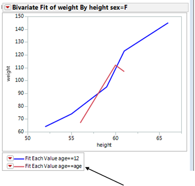

The issue appears to be a scoping problem.  I was not able to run your script successfully until I added
Names Default to Here( 1 );
Here is your script with the column names pointing to the Big Class data table.
names default to here(1);
dt=open("$SAMPLE_DATA/big class.jmp");
age=13;
Bivariate(
Y( :weight),
X( :height),
Show Points( 0 ),
Fit Where(
:age == 12,
Fit Where(
:age == age,  //this is troublesome line... the graph is generated but not quite right.
By( :sex)

Thank you very much for the quick responses. i forgot to copy it into my example but the very beginning of my script started with "names default to here(1);"  Don' think it matters where that command apperas within the script, so long as it is before the relevent function.
I tried Jim's code first and it produced the same problem as my original script.  The value 13 was not dispayed below the graph, but instead "age==age".  note: i'm running JMP 12
