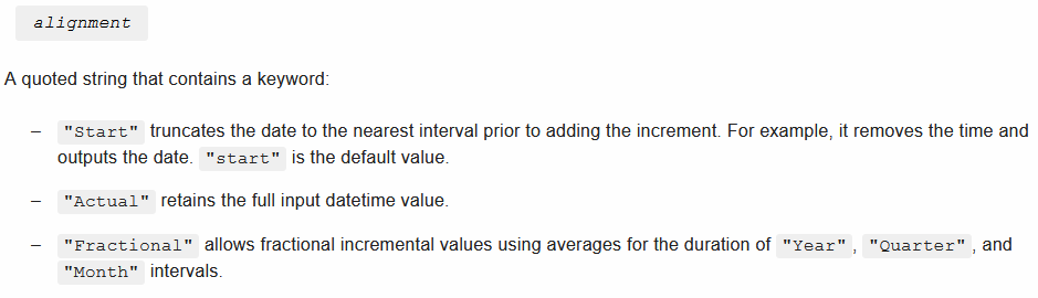

Date Increment() which was suggested is the best option. Only thing you have to remember with that is to use alignment "actual" (it default to start) IF you care about the seconds. If you leave it as default (start), it will remove seconds. You can compare these two formulas
Date Increment( :Col1, "Minute", :Col2)
Date Increment( :Col1, "Minute", :Col2, "actual")
