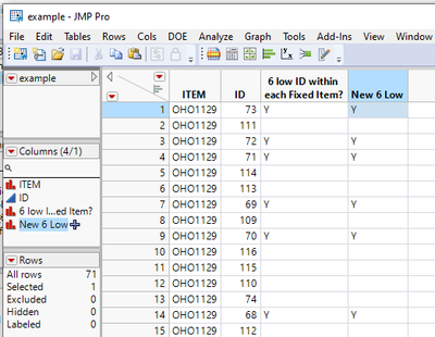

about JSL formula to mark lowest 6 numbers within each fixed Item
I have one table with column "ITEM" and "ID", and the "ID" column value is random, could help to suggest how to use JSL formula to create one new column, and fill in content "Y" when the "ID" value is the lowest 6 within each fixed "ITEM" value. thanks a lot

Re: about JSL formula to mark lowest 6 numbers within each fixed Item
You can also use Col Rank combined with if:
tempRank = Col Rank(:ID, :ITEM);
If(tempRank <= 6, "Y", "");

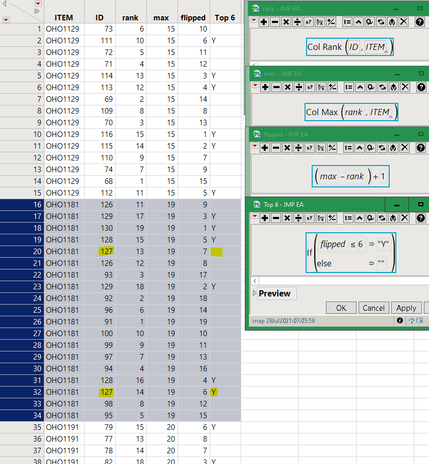

Craige_Hales
Very nice, I was only barely aware of the 2nd argument, ByVar, to the Col functions. ColMax has it too, so the top 6 can be selected. (The by groups have different number of rows, a constant won't work.) max and rank and flipped are column names; the formula's column name is in the window title. The column name is used in subsequent formulas.
The formulas could be collapsed into one column; add parenthesis as needed. Expanded like this is easier to understand.The formulas could be collapsed into one column; add parenthesis as needed. Expanded like this is easier to understand.
ColRank has a rule for ranking duplicates; if you care about duplicates on the edge of top or bottom 6, check it out. In the 2nd by group, the ID 127 kept row 32 but not row 20 because of the flip. Without the flip, the rank would keep the earlier row.
Craige
