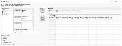

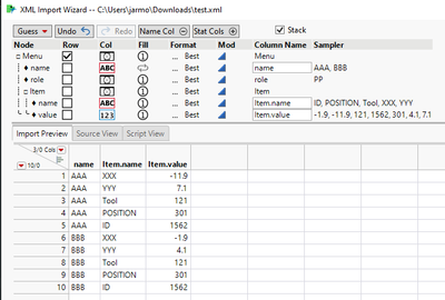

jthi
Re: XML parsing to JSL Help
I would most likely start by trying the interactive XML import wizard
From here you can clean the data and modify it if needed and then you can split it
JMP is able to record most of the steps you need to get here (check enhanced log and source scripts of tables)
-Jarmo
