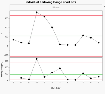

X axis for Control Chart Builder JMP 19

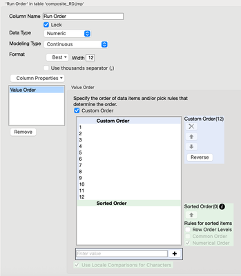

When I use the control chart builder in JMP 19, the X axis is not adjusting to the correct order.  I even tried Value order on and off and it does not make a difference
Why isn't the x axis changing to the correct order?  I am on a MacBook, but it also does it on Windows.

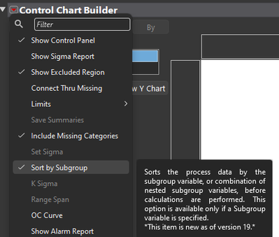

Seems like you have to enable Sort by Subgroup in JMP19

Thank you!  I found it in preferences.  I have used JMP since JMP 4 and have never had to do this before.

Re: X axis for Control Chart Builder JMP 19
Yeah, having to do this is a bit weird and it isn't the only change I would consider weird that came with JMP19.
