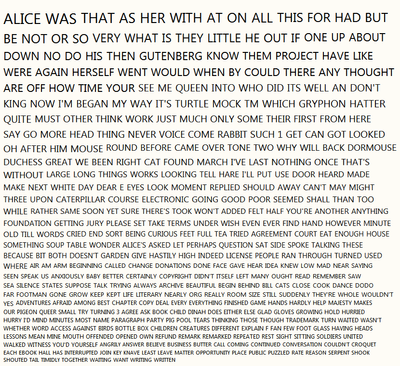

Craige_Hales
Re: Word Cloud in Graph Builder?
The NY Times look is nice because it is easy to implement.
Here's some JSL

The PatMatch statement uses some regular expressions to identify the words in the text, upper case them, and use them as the keys to an associative array.  The associative array elements default to zero if they don't already exist (see the =>0) so no special effort is required for the first instance of a word.  The PatRepeat within the PatMatch processes the entire string.  Within the repeat the two regex alternate processing words and stuff between words.  Within the first regex, expr is used to execute some JSL on each matched word.  The last thing the expr does is evaluate to an empty string which will always match at the current position.  This PatMatch processes about 150K characters in about two seconds, including counting the words into the associative array.
A data table is constructed from the key-value pairs and sorted, then a window is created with a vertical list box containing a bunch of horizontal list boxes.  The horizontal list boxes are filled with the words, from left to right.  After adding each word, the wait(0) allows the window to update so the width of the horizontal text box will be correct (and you get to watch it.)  When the box exceeds 700 pixels, start a new line.
Start at row 12 to skip THE AND TO A OF IT SHE SAID YOU IN I.  Stop when the sorted count goes below 8 instances.  Use a log transform; Alice has 386 instances.
As Xan points out, there are issues with words that are only different in suffix, prefix, or synonyms.  Probably some other issues too.
Jabberwocky is in Through the Looking Glass.  Slithy Toves are not here.
update: probably shouldn't fetch text from the link every time.  Point the loadtextfile to some file on your computer, perhaps downloaded from http://www.gutenberg.org/
Craige

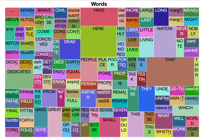

stan_koprowski
Hello Peter,
Here is some JSL to count the words in a text file and then create a tree map.
Not exactly a word cloud but could get you started in the direction you want.
Best,
Stan

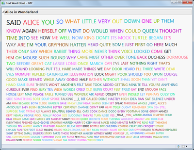

pmroz
I added stop words and color to the output.  Also made dt an invisible table.
